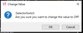

The dialog box that appears when a widget etc. has the "Confirmation Dialog" active:

The dialog box that appears when a widget etc. has the "Confirmation Dialog" active: ![636c2fbf75ef3](serve/attachment&path=636c2fbf75ef3)
To elaborate - it would be useful to add and instruction text to this that may remind the operator what to check before doing this action etc. or even add an image - i.e. safety warning etc.
Thanks for the update. You can find and edit the change value message in Settings -> Languages. Just search for the string, and you can edit it from there.

Thanks for the update. You can find and edit the change value message in Settings -> Languages. Just search for the string, and you can edit it from there. To understand how %0 is used in the string, you can read up on that and working with the language strings here: https://www.vtscada.com/help/Content/D_Customize/Dev_LanguagePanel.htm
