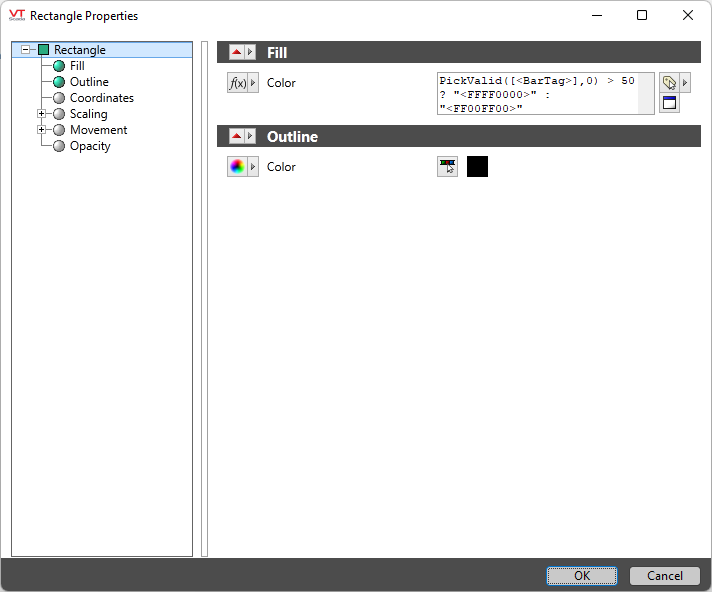

Copy the following and Ctrl+V it into the idea studio. From there you can update the expression in the rectangle properties to point to your tag, setpoint, colors etc:
  GUIRectangle(424, 401, 792, 380,
               1, 1, 1, 1, 1 { Scaling              },
               0, 0          { Movement             },
               1, 0          { Visibility, Reserved },
               0, 0, 0       { Selectability        },
               Brush(PickValid(PickValid([<TagName>],0) > 50 ? "<FFFF0000>" : "<FF00FF00>", "<FF000000>"), 0, 1), Pen("<FF000000>", 1, 1));
Copy the following and Ctrl+V it into the idea studio. From there you can update the expression in the rectangle properties to point to your tag, setpoint, colors etc: ```` GUIRectangle(424, 401, 792, 380, 1, 1, 1, 1, 1 { Scaling }, 0, 0 { Movement }, 1, 0 { Visibility, Reserved }, 0, 0, 0 { Selectability }, Brush(PickValid(PickValid([&lt;TagName&gt;],0) &gt; 50 ? &quot;&lt;FFFF0000&gt;&quot; : &quot;&lt;FF00FF00&gt;&quot;, &quot;&lt;FF000000&gt;&quot;), 0, 1), Pen(&quot;&lt;FF000000&gt;&quot;, 1, 1)); ````
The code above is essentially a shortcut to accomplishing the following:
621e4c1684ef3
The code above is essentially a shortcut to accomplishing the following: ![621e4c1684ef3](serve/attachment&amp;path=621e4c1684ef3)
