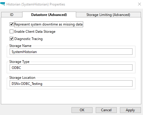

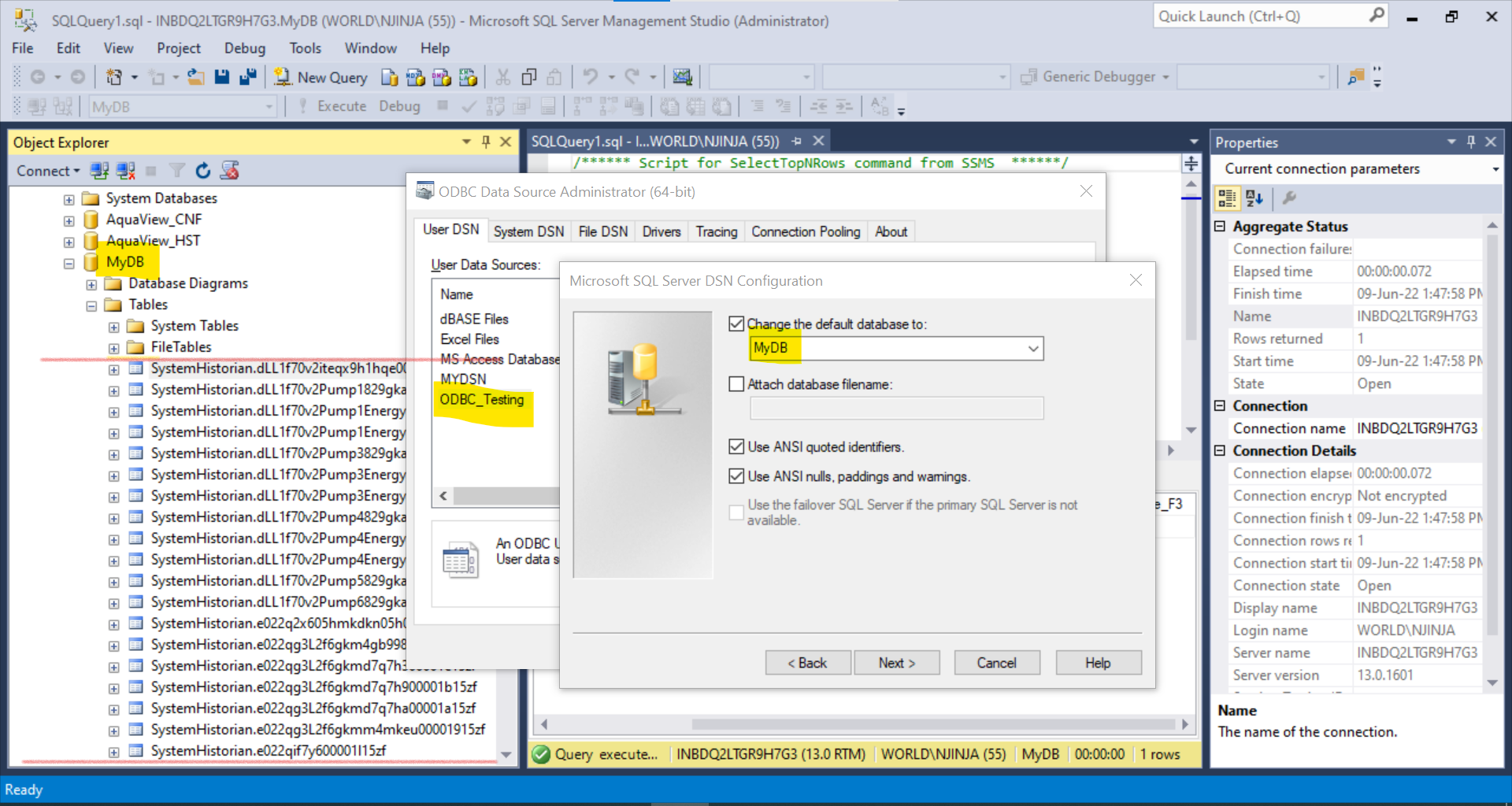

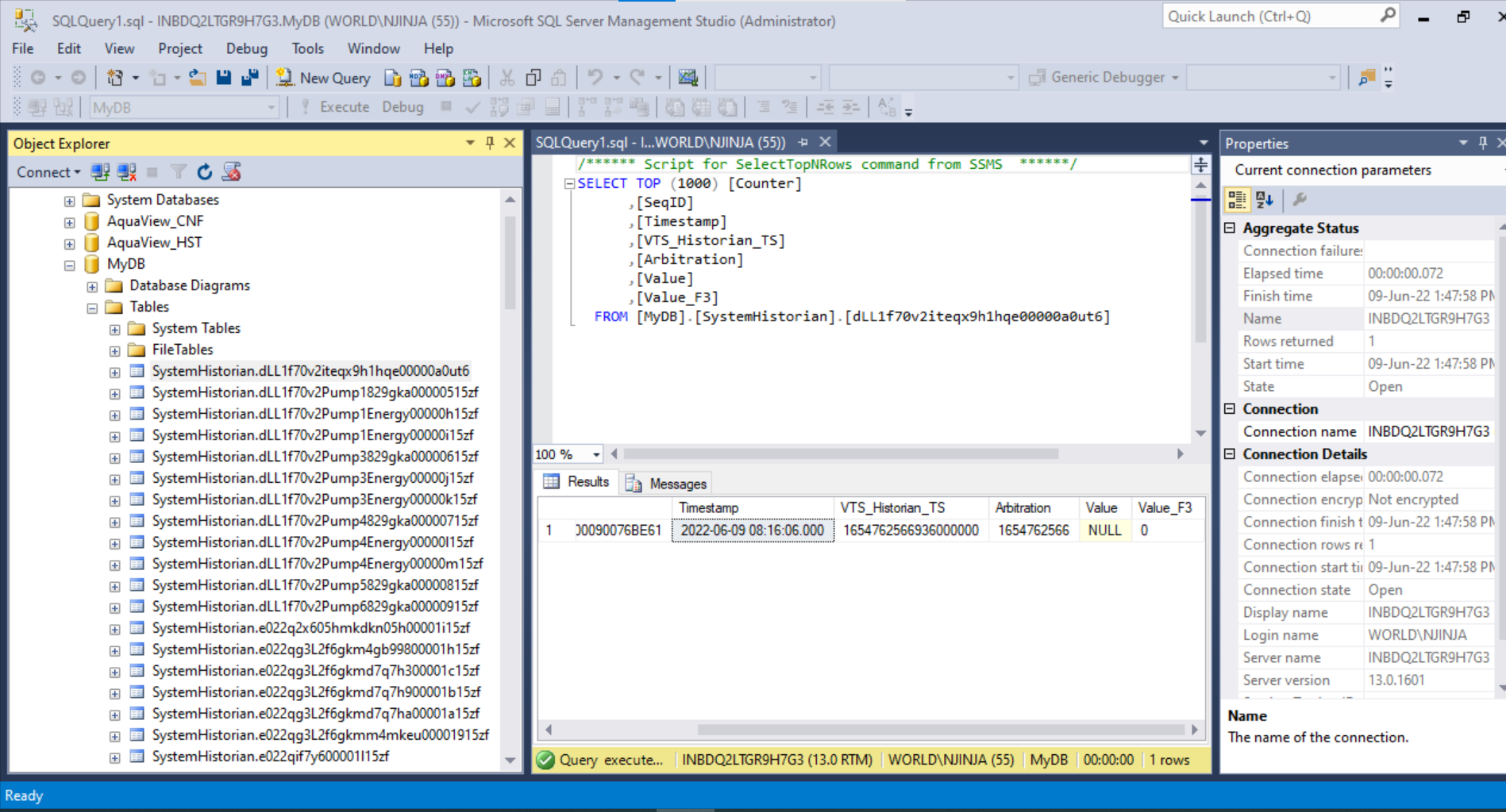

I tried to access the Default System Historian of VTScada into MS SQL by adding the DSN name to the SystemHistorian tag & after restarting the application I got tables in my MS SQL database but the tables name is not much familiar to look in.

The table names & information inside are not appropriate.

As an additional comment, your SQL tables look like they are set up. I believe you just need to find or create a reference between the tag's unique ID and the tag name. Note that this can easily be done using the REST interface or by exporting the tags to excel (you'll find this in settings).
