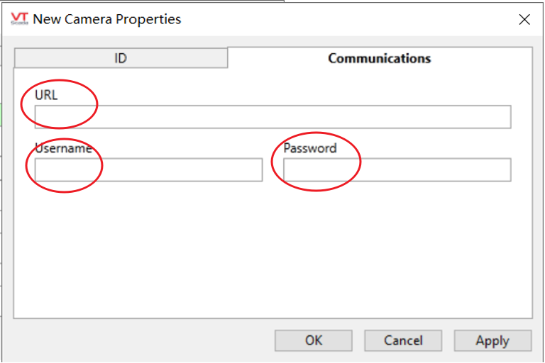

I want to create a Camera tag for "Camera Viewer" widget. What shoud I key into the Communication page about URL/Username/Password? Can you give me a public URL which I can use. Thank you.
62b475bea43f6
I want to create a Camera tag for "Camera Viewer" widget. What shoud I key into the Communication page about URL/Username/Password? Can you give me a public URL which I can use. Thank you. ![62b475bea43f6](serve/attachment&path=62b475bea43f6)
The camera needs to stream MJPEG (MJPG) video and your URL typically requires the port as well. IE: 192.168.1.100:8000
Often, no username or password is required as in this case to a public URL on the default port:
https://jdee-dl.uarhelp.com/axis-cgi/mjpg/video.cgi?resolution=640x480
The camera needs to stream MJPEG (MJPG) video and your URL typically requires the port as well. IE: 192.168.1.100:8000 Often, no username or password is required as in this case to a public URL on the default port: https://jdee-dl.uarhelp.com/axis-cgi/mjpg/video.cgi?resolution=640x480
