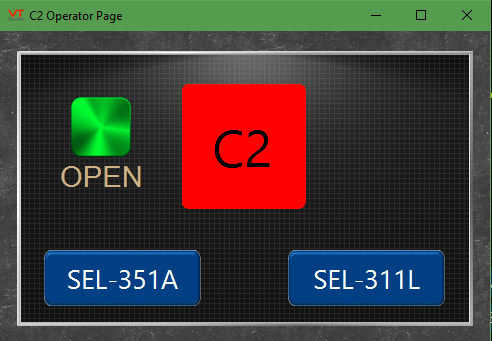

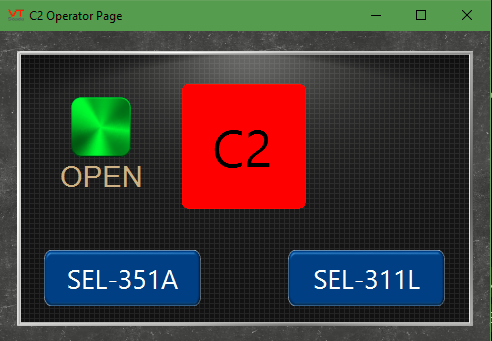

Here is some example code and pictures for creating a dynamic page jump.
  pTagSelection Object<SEL2411, SEL2414, SEL2431, SEL2523, SEL2523AG, SEL2533, SEL300G, SEL311C, SEL311L, SEL351, SEL351_7, SEL351A, SEL351R, SEL351S, SEL3530, SEL3530_4, SEL387, SEL387A, SEL387E, SEL411L, SEL421, SEL487V, SEL501, SEL551C, SEL587, SEL587Z, SEL651R, SEL700G, SEL735, SEL751, SEL751A, SEL787>;
  wName <:"l7dexTxWv":> Text;
  Title = "IinbjDJpQ";
  Color = "<FF202020>";
  ScaleDisplayContent = 1;
  Bitmap = "Bitmaps\Tiles\Opaque\Slate.png";
  PageBMPBrightness = 1;
  PageBMPTransparency = 1;
  PageBMPContrast = 1;
  PageBMPMirror = 0;
  PageBMPColorize = "<FFFFFFFF>";
  PageBMPTile = 1;
  PageBMPTileScale = 1;
  PageBMPStretch = 0;
  PageBMPMarginTop = 41;
  PageMaintainAspectRatio = 1;
  PageChangeName1;
  PageChangeName2;
  WinFlag = 1;
  PageX;
  PageY;
  PageHeight = 625;
  PageWidth = 490;
  PageMinWidth;
  PageMinHeight;
  PageVWidth;
  PageVHeight;
  PageToolTipLabel;
  IsVic ;
Init[
    If 1 Main;
        IsVic = IsVICSession(True) ? 0 : 1;
Main [
  Title = CONCAT(\GetPhrase(pTagSelection\Variables\IED1Tag\Device)," Operator Page");
  Return(Self);
  PageChangeName1 = pTagSelection\Variables\IED1Page\Value;
  PageChangeName2 = pTagSelection\Variables\IED2Page\Value;
  GUITransform(44, 274, 200, 219,
               1, 1, 1, 1, 1 { Scaling              },
               0, 0          { Movement             },
               PickValid(pTagSelection\Variables\IED1Type\Value == "" ? 0 : 0.001, 0), 0          { Visibility, Reserved },
               0, 0, 0       { Selectability        },
               Scope(\Code, "Library", TRUE)\PageChange(PageChangeName1, 1, pTagSelection\Variables\IED1Tag\Value));
  GUITransform(288, 274, 444, 219,
               0, 0          { Movement             },
               PickValid(pTagSelection\Variables\IED2Type\Value == "" ? 0 : 0.001, 0), 0          { Visibility, Reserved },
               Scope(\Code, "Library", TRUE)\PageChange(PageChangeName2, 1, pTagSelection\Variables\IED2Tag\Value));

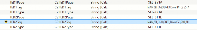

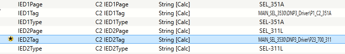

Note the
PageChangeName[#]
This is a dynamic variable that draws its value from a tag nested in the linked tags tree.
635ab64e3856b

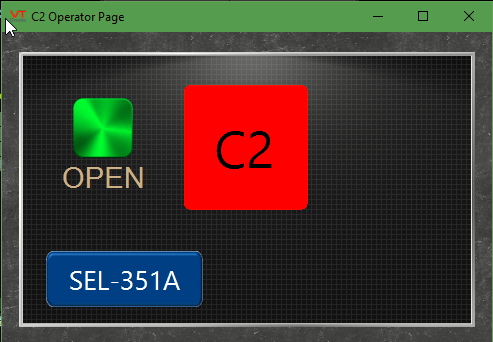

Note that the second tag is blank, which in turn causes the second link to stay transparent.
635ab8bd0ef3f

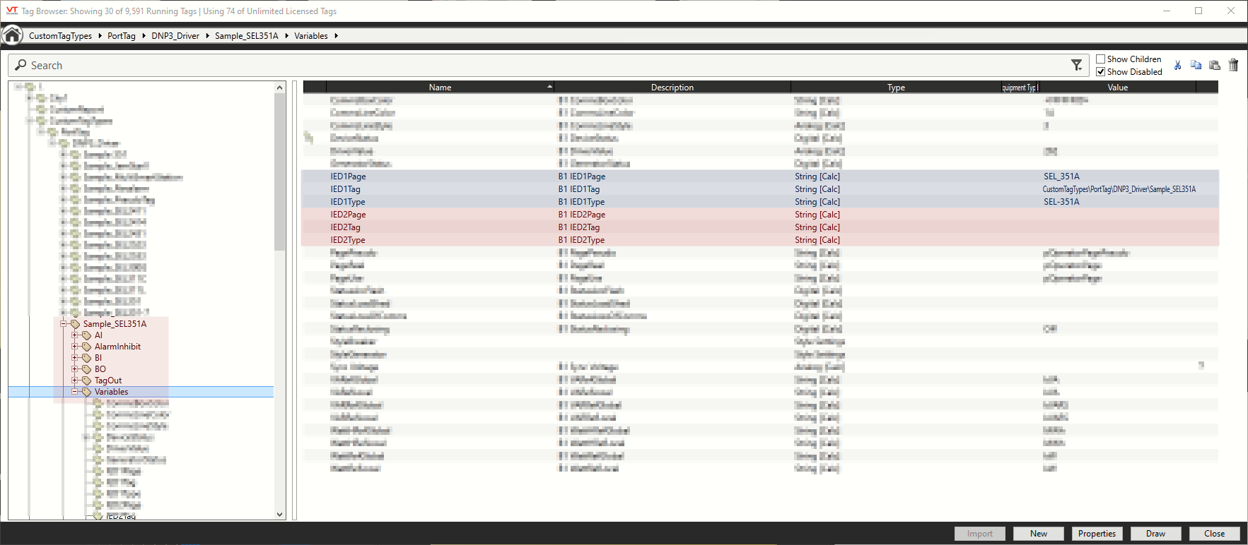

If I would added a second tag reference...
635ab97c0ef07
Then another page jump button shows up.
Note: The text on page jump buttons comes directly from the tags they are link to. This is not hard coded.
635ab9c104203
This is all to show that you can use the information in a tag tree to dynamically change your list.
Hope this is useful!

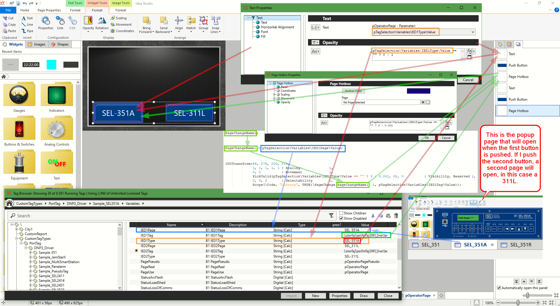

All these screen snips together is likely VERY confusing, but I wanted to get it all on the same picture.
635c192479821
This may help show the sequence of data, if you are able to decipher it smile

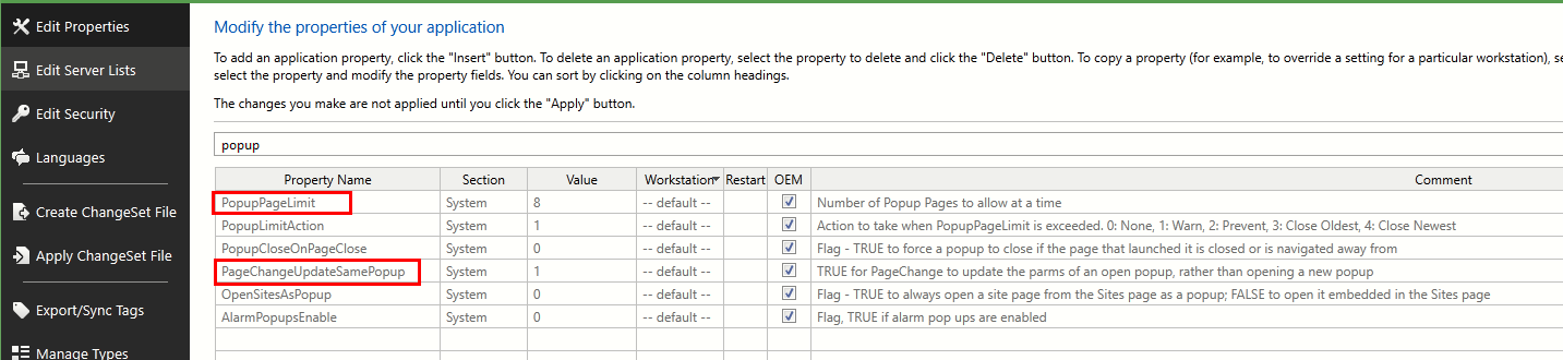

Also, please check your popup page parameters. This may be the root cause.
635c1a400cb93
All these screen snips together is likely VERY confusing, but I wanted to get it all on the same picture. ![635c192479821](serve/attachment&amp;path=635c192479821) This may help show the sequence of data, if you are able to decipher it :) Also, please check your popup page parameters. This may be the root cause. ![635c1a400cb93](serve/attachment&amp;path=635c1a400cb93)
