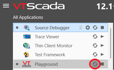

Once you have saved the new code, remember to open the VAM ( VTScada Application Menu ) and click the Import changes button as shown below:
64ad80bb0c530
I believe you'll need to ensure your user has the manage tag type privilege to create the tag type in the first place. Then, you will head to the tag type source code ( Path Example: 'C:\VTScada\AI.src' ) In that file, you'll want to find the TagMain section and place your code in that section. You'll need to create a condition to watch for changes to your tag and then write those changes to the Value property of the tag type. For example: ```` If Watch(1, \Scaled\Value); [ \Value = \Scaled\Value; ] ```` Once you have saved the new code, remember to open the VAM ( VTScada Application Menu ) and click the Import changes button as shown below: ![64ad80bb0c530](serve/attachment&path=64ad80bb0c530)
