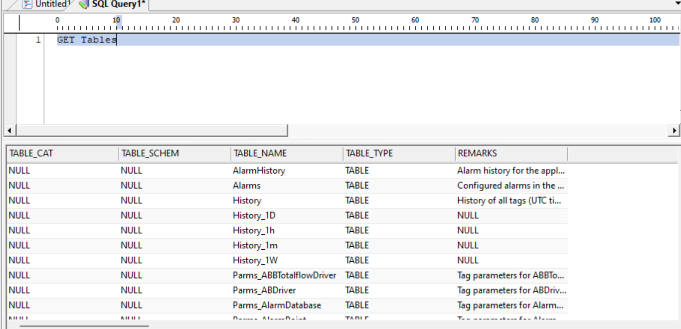

hi everyone, where i can find TABLE_NAME in VTSCADA ? thanks
![64b6b7d752400](serve/attachment&path=64b6b7d752400) hi everyone, where i can find TABLE_NAME in VTSCADA ? thanks
Most of the info on the calls can be found here: https://www.vtscada.com/help/Content/D_LogAndReport/Dev_ODBCTableStructure.htm?tocpath=Use%20VTScada%7CLog%252C%20Note%252C%20and%20Report%7CSQL%20Queries%7C_____2
Here are some example queries: https://www.vtscada.com/help/Content/D_LogAndReport/Dev_SQLQueryExamples.htm?tocpath=Use%20VTScada%7CLog%252C%20Note%252C%20and%20Report%7CSQL%20Queries%7C_____3
Most of the info on the calls can be found here: https://www.vtscada.com/help/Content/D_LogAndReport/Dev_ODBCTableStructure.htm?tocpath=Use%20VTScada%7CLog%252C%20Note%252C%20and%20Report%7CSQL%20Queries%7C_____2 Here are some example queries: https://www.vtscada.com/help/Content/D_LogAndReport/Dev_SQLQueryExamples.htm?tocpath=Use%20VTScada%7CLog%252C%20Note%252C%20and%20Report%7CSQL%20Queries%7C_____3
