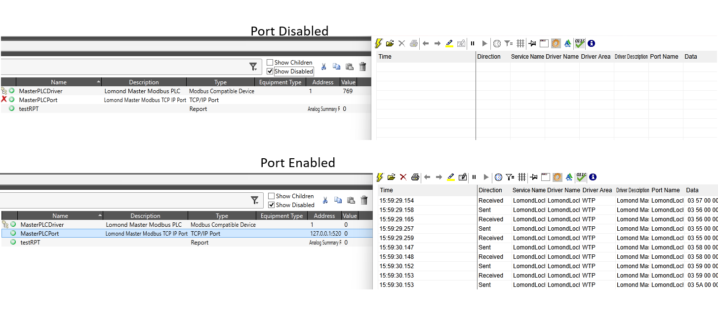

I did a quick test in VTScada using a simple system and wasn't able to see any polling with the port tag disabled. I used VTScada's built in trace viewer app to check for driver traffic while toggling the port. a sample of each is shown below. You can add the trace viewer by adding an existing application in VTScada to check out your own traffic.
650351a984c2a
Please be sure to also disable any port tags in VTScada also to stop the drivers from polling. This includes any parents to the port tags in use as [*Driver] will find the first parent it can. Also, please be sure to deploy changes to all servers to ensure they are not simply made to the primary server. I did a quick test in VTScada using a simple system and wasn't able to see any polling with the port tag disabled. I used VTScada's built in trace viewer app to check for driver traffic while toggling the port. a sample of each is shown below. You can add the trace viewer by adding an existing application in VTScada to check out your own traffic. ![650351a984c2a](serve/attachment&path=650351a984c2a)
