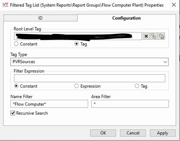

you can use the "Filtered Tag List" tag. it is in the O&G layer so you might be out of luck if your not using it.
Then you can jsut save that tag in you report group and anyhting that matches the filter will automaticlly get aded to the report.

you can use the "Filtered Tag List" tag. it is in the O&G layer so you might be out of luck if your not using it. Then you can jsut save that tag in you report group and anyhting that matches the filter will automaticlly get aded to the report. ![65f49f25d34aa](serve/attachment&path=65f49f25d34aa)
Thanks Kevin. Not using O&G but I'll ask my local sales guy if he has a way around it.
