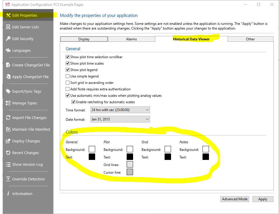

Any way to change the Backround color of the Historical Data Viewer? It would be nice to be able to change to black for better contrast.

Is the below what you are looking for?
