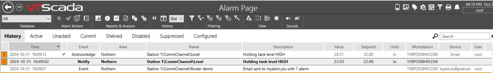

Alarm Event is attached for your reference Sir. Automatically acknowledged immediately.
![672349ee3fb87](serve/attachment&path=672349ee3fb87) Alarm Event is attached for your reference Sir. Automatically acknowledged immediately.
My best guess is that the email has some kind of autoresponder. Can you confirm that this isn't the case?
