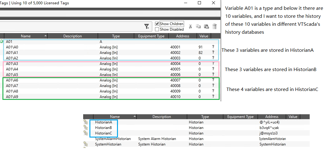

As shown in the figure below:
Variable A01 is a type and below it there are 10 variables, and I want to store the history of these 10 variables in different VTScada's history databases
Are there any 2 benefits to doing so?
1.Users can set the retention time of the database data according to their needs, for example,
HistorisanA is retained for 1 year,
HistorisanB is retained for 2 years,
HistorisanC is reserved for 3 years;
2.Is this possible to improve the speed of querying the data, since the data is recorded in different databases, and the capacity of each database will not be very large
Thank you

Hi,support As shown in the figure below: Variable A01 is a type and below it there are 10 variables, and I want to store the history of these 10 variables in different VTScada's history databases Are there any 2 benefits to doing so? 1.Users can set the retention time of the database data according to their needs, for example, HistorisanA is retained for 1 year, HistorisanB is retained for 2 years, HistorisanC is reserved for 3 years; 2.Is this possible to improve the speed of querying the data, since the data is recorded in different databases, and the capacity of each database will not be very large Thank you ![673c66ccda18c](serve/attachment&path=673c66ccda18c)
