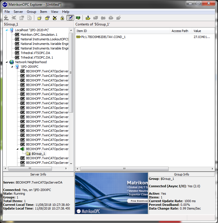

I am having a problem reading tags from my OPC Server using VTScada Light. The server is located on an external PC and the connection to the client PC is made through DCOM. I know the DCOM configuration is correct because I can use Matrikon OPC Explorer on the client PC to read all the servers and tags on the external PC. I just can't replicate this within VTScada. This first screenshot shows Matrikon OPC Explorer can successfully read the PLC tags from the external server over DCOM. 5be45a8b4eb55

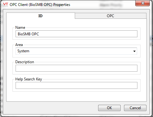

In VTScada I tried to set up an OPC Client as shown below.5be45afcbcfd6

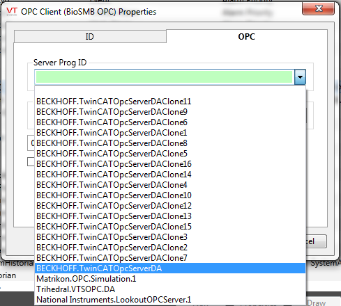

5be45b2d59e7a
As you can see, VTScada has no problem finding the server.

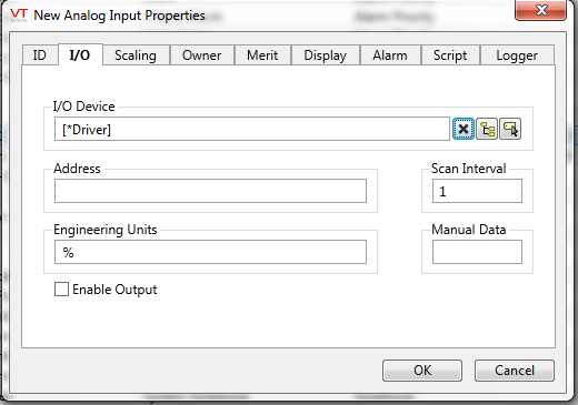

However, when I try to add a child analog input to the OPC Client I don't see the tags button next to the address box. 5be45bcc2f27e
I suspect I am simply setting this up incorrectly as the DCOM has been proven to work with Matrikon. Is there anything else I need to do before setting up the OPC Client in VTScada?
