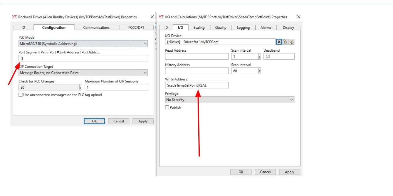

I've attached a picture of the two main problems I had while setting up my connection. The other issue that we did not discuss was the fact that I was running the connection through a server and then a separate switch and I needed to set my PC's IP address rather than let the server assign an IP.
63ddf11e0b4b5
Hi Dave! My final project presentation went great to my surprise and massive relief. Thank you again for all your help in connecting to the PLC. I've attached a picture of the two main problems I had while setting up my connection. The other issue that we did not discuss was the fact that I was running the connection through a server and then a separate switch and I needed to set my PC's IP address rather than let the server assign an IP. ![63ddf11e0b4b5](serve/attachment&path=63ddf11e0b4b5)
