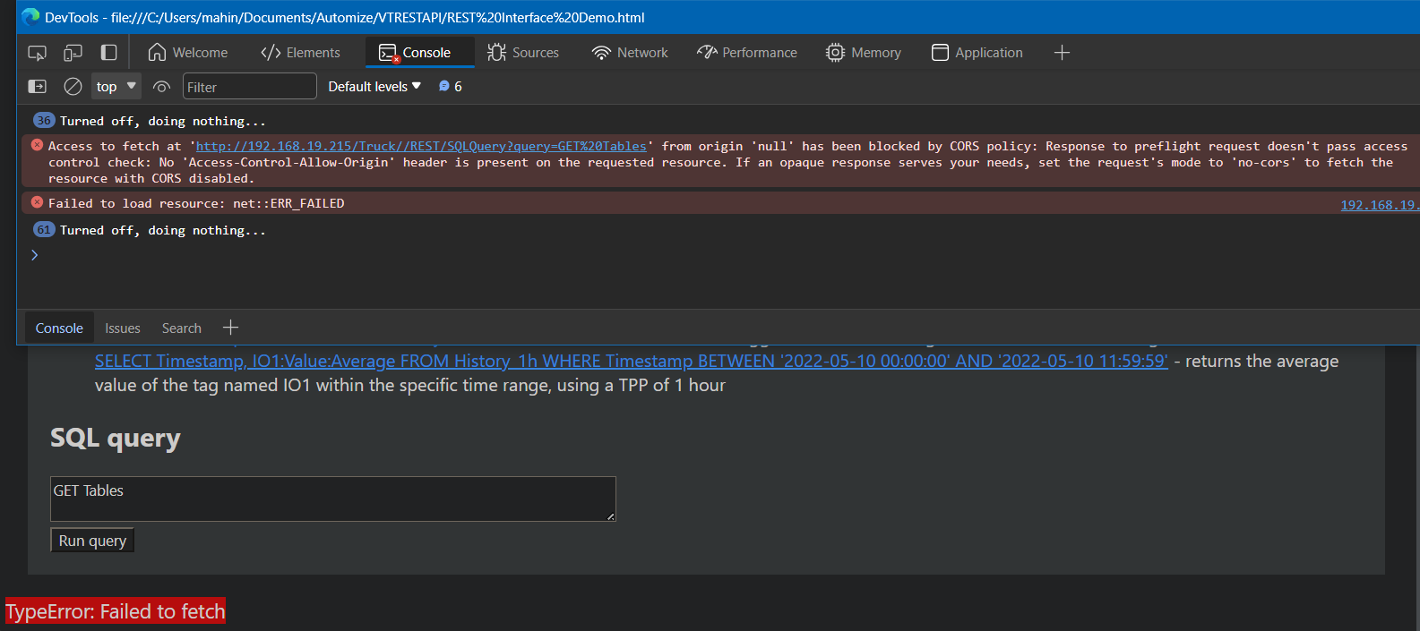

I am trying to test the REST Queries .
I have set the application property "RESTAllowedOrigins" to null as given in your example HTML page.
I get TypeError failed to Fetch at the bottom of the page (in Red colour)

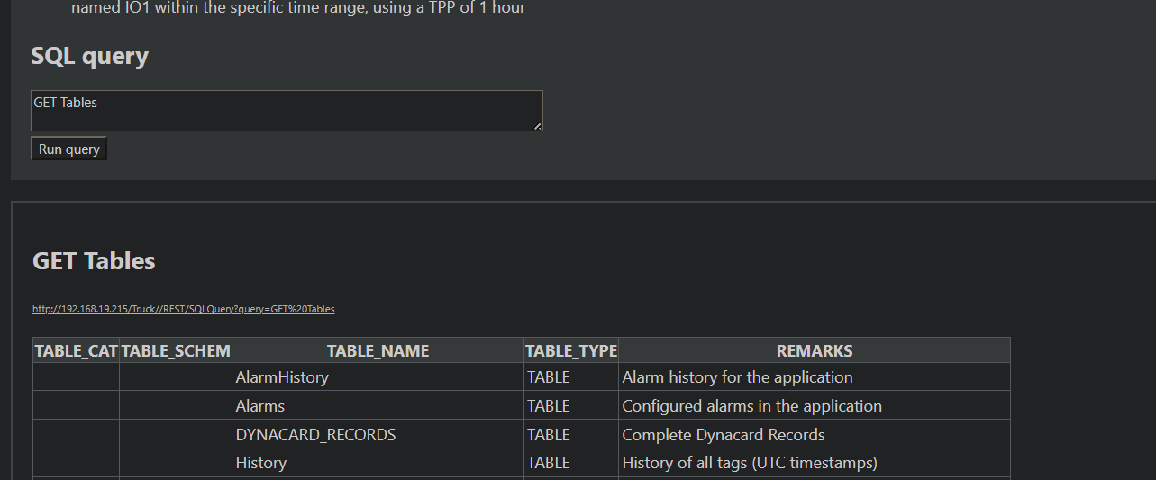

But to pinpoint where exactly things went wrong, I edited .html_ file and added some console.log to "see" what the "Run Query" button is executing, taking the inputs. But u dont need to do that for your specific problem.
Just open browser devtools, go to console. You will see this faced error.
65ba1619d6298
This means that the COR error still is on, 65ba172821ac1

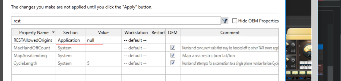

**You have to set this as "System", not application.
After setting this as a "System" property it works for me.65ba17a7247d7
