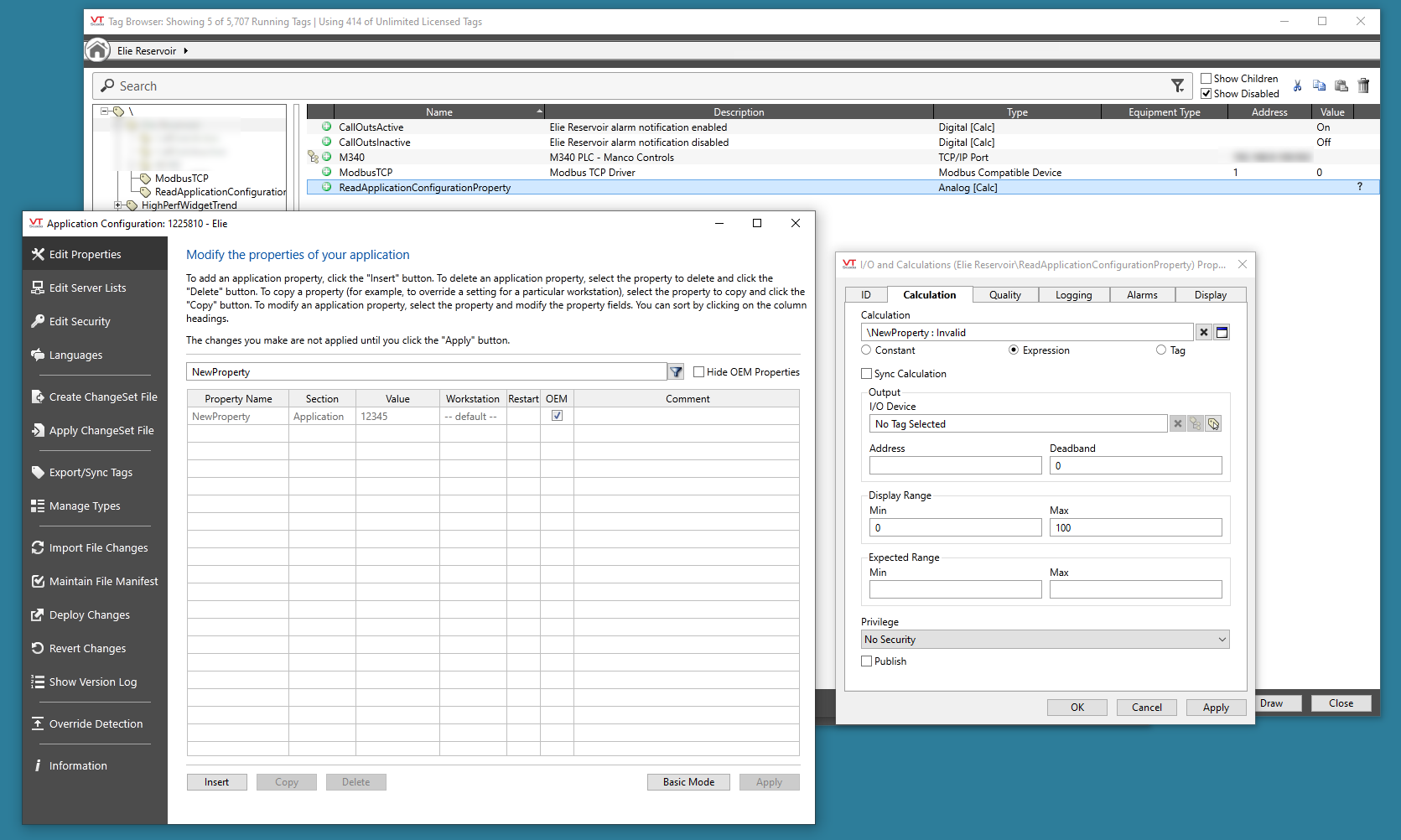

trying to find expression to read an application property
I've added a custom property to my application which I'd like a VTScada I/O & calculation tag to know about. It's in the Application Section, named BarHistLenth, & has a numeric value.
Can't find a valid expression for my I/O & calc tag. Figured I better ask 'cause trying to do something that can't be done takes forever.
I've added a custom property to my application which I'd like a VTScada I/O & calculation tag to know about. It's in the Application Section, named BarHistLenth, & has a numeric value. Can't find a valid expression for my I/O & calc tag. Figured I better ask 'cause trying to do something that can't be done takes forever.

I tried the \ prefix but was told my expression is invalid. Perhaps my question was confusing. Please refer to the screengrab below. I'm looking for an expression which will read the value 12345 from my Application's Configuration.
641379740d8ee
I tried the \ prefix but was told my expression is invalid. Perhaps my question was confusing. Please refer to the screengrab below. I'm looking for an expression which will read the value 12345 from my Application's Configuration. ![641379740d8ee](serve/attachment&path=641379740d8ee)

120
