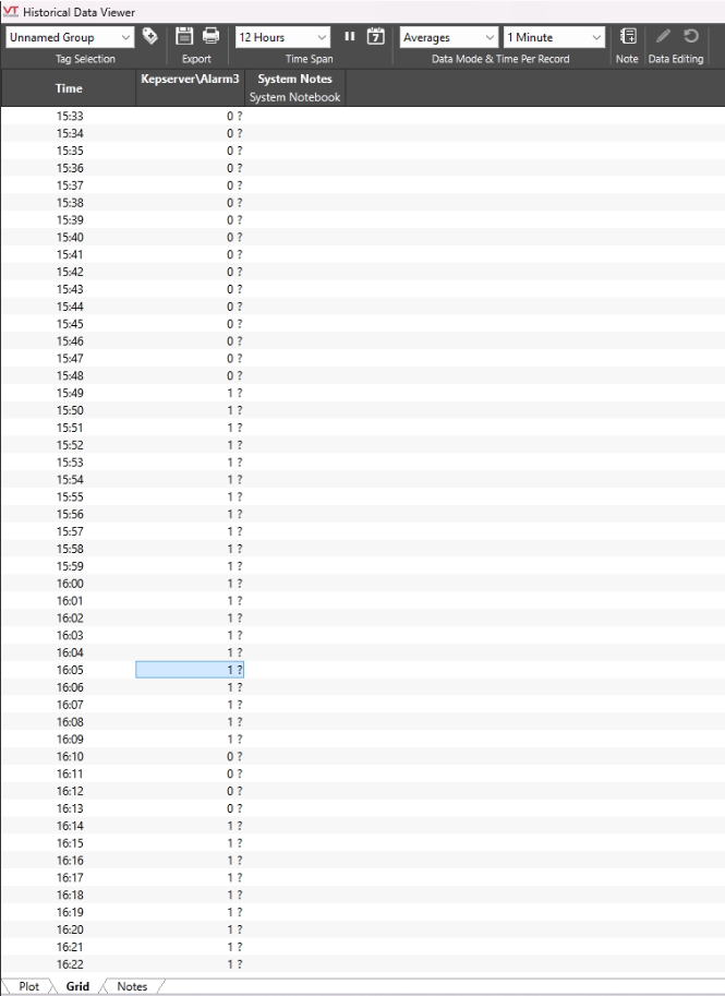

Hello Team,
We are working on reading the data using VTScada REST queries. While working History_TPPvalue tables we are trying to read Average values. While comparing the result in the Tag browser we found that the values are not the same. I have attached the screenshot for Historical Data Viewer and also the txt file with the REST query and its response. Could you please help me to understand if I am doing anything wrong here while comparing the data? For my use-case, I'm logging only 1 and 0 values as numbers.

I sent this to our Dev team this morning and they suggested the following:
Please have the customer 'Adjust the tags' Digits After Decimal parameter to see digits after the decimal point in HDV.'
Please give that a shot and let me know if it solves this.
As an aside, please also note that the sample query is for Alarm 1 and 2 while the HDV example is for Alarm 3. We expect you are aware of this but just wanted to clarify.
