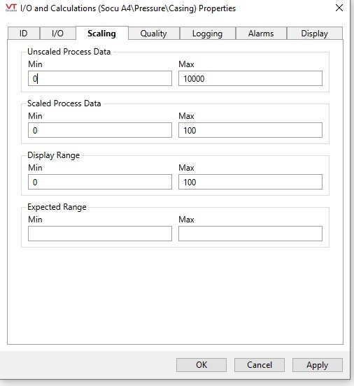

Hi Dave,
The tag is scalled with 0 min value.
64992a822f963
Still i get the negative value.
64992a81db4d4
Hi Dave, The tag is scalled with 0 min value. ![64992a822f963](serve/attachment&path=64992a822f963) Still i get the negative value. ![64992a81db4d4](serve/attachment&path=64992a81db4d4)
edited Jun 26 '23 at 7:07 am

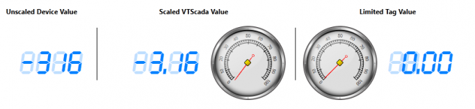

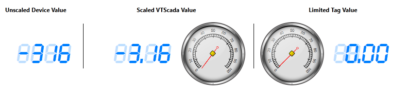

Sorry, the display range is for certain widgets but does not affect the tags read value. The scaled range only affects a tags write value range and not the read value range.
If your scaled number is correct but you want to limit it, you can create a calculation tag which references the tag and limits the value.
The calculation tag expression would simply be:
//Example using tag absolute path
Limit([<path/to/reference/tag>],0,100)
//Example using relative path to parent tag
Limit([..],0,100)
The output would be similar to that below:
649b0b24ecf55
If you need to do this a bunch of times, consider creating a tag type for this. It's more effort up front but may provide some great experience and will be more efficient in the long run.
