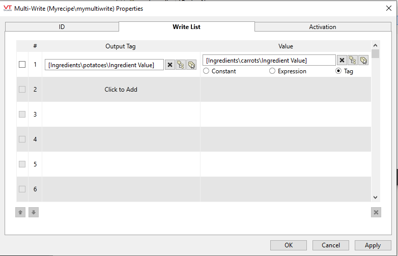

It doesn't let you do this?
666b0a4c88262
It doesn't let you do this? ![666b0a4c88262](serve/attachment&path=666b0a4c88262)
That's accurate but we have recipes management built it. Are you able to save strings to a PLC location? If so, using recipes, is the easiest method to do this.
Otherwide, you may need to use an equipment type to interrput discrete values to strings.
That's accurate but we have recipes management built it. Are you able to save strings to a PLC location? If so, using recipes, is the easiest method to do this. Otherwide, you may need to use an equipment type to interrput discrete values to strings.
