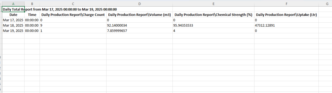

I am having an issue with a daily report that i have configured.
My understanding is that a daily report is a sum of the values accumulated for a each of a selected set of tags within the time period you specify.
Very simple i have four tags which values change approx. 4 times a day, in theory these values should be added together and displayed as a 'Daily Total'... Right?
My values are way higher than they should be and cant figure out why!
I have attached a screenshot of my report... Configured to display current calendar week.
For instance March 18 Should be...
Count = 1
m3 = 7
% = 4.1
Ltr = 2737
All for tags have been configured as Analog I/O tags with the applicable ranges set.

I believe the answer is...
These for tags values were set to ZERO at points during the day therefore...
If the count restarts or rolls over each time a maximum value is reached the total will be the number of rollovers times the maximum value, plus the difference between the last value recorded and the first value recorded.
