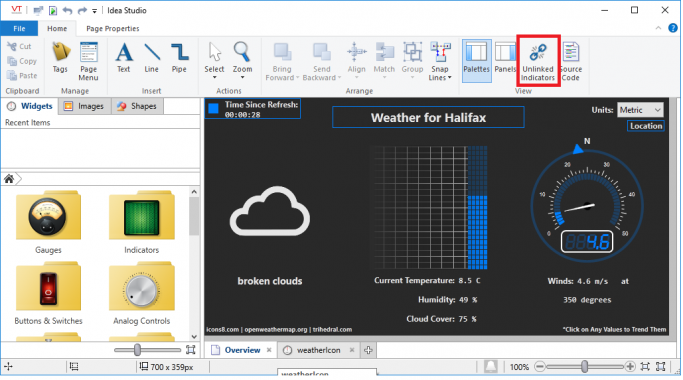

You'll want to click the Unlinked Indicators button on the Home ribbon of the Idea Studio. See the image below:
5b06dcb3e49c3
You'll want to click the Unlinked Indicators button on the Home ribbon of the Idea Studio. See the image below: ![5b06dcb3e49c3](serve/attachment&path=5b06dcb3e49c3)

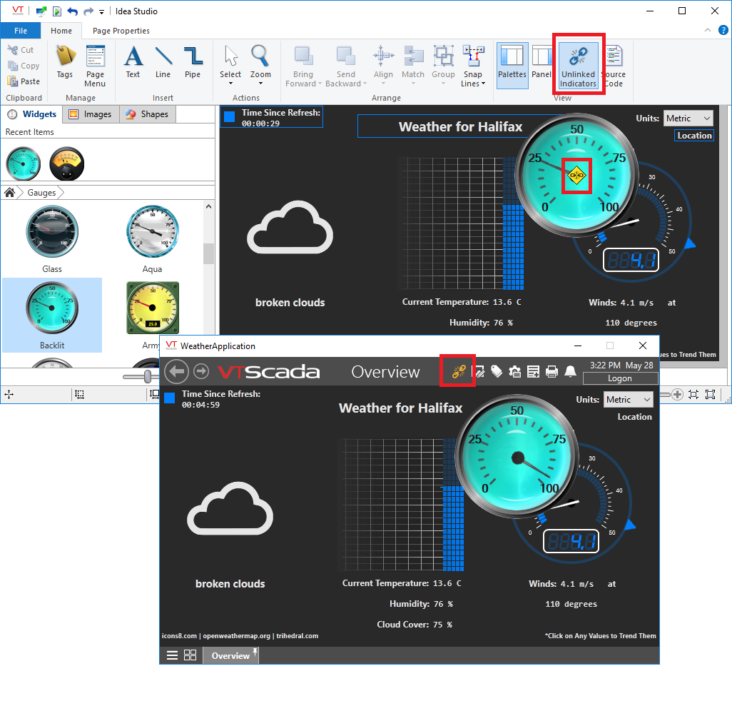

You should see an indicator whic looks like the one shown below on the Idea Studio as well as the Application HMI.
5b0c493d51953
You should see an indicator whic looks like the one shown below on the Idea Studio as well as the Application HMI. ![5b0c493d51953](serve/attachment&path=5b0c493d51953)

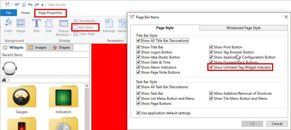

@nadeem, Another place that you might want to look for is Page Properties > Bar Items and make sure that the Show Unlinked Tag Widget Indicator is checked
5b0d4ef52a555
@nadeem, Another place that you might want to look for is Page Properties > Bar Items and make sure that the Show Unlinked Tag Widget Indicator is checked ![5b0d4ef52a555](serve/attachment&path=5b0d4ef52a555)
