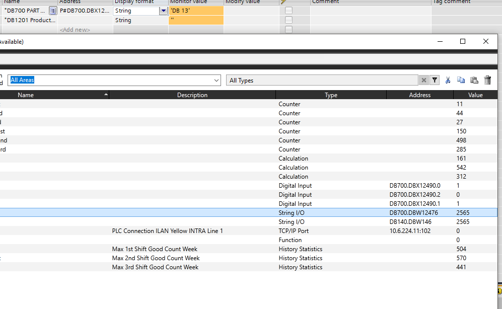

When viewing a string in VTSCADA I am getting a numeric value instead of characters.

Bottom is the string that I am reading from the PLC live via the Siemens TIA Portal Version 15

The string IO tag is designed to bring in a n ASCII string data type from the device. As the Rockwell Compactlogix/Controllogix have a string data type as do JSON and SNMP. It does not parse a character values and turn them into strings. I don't think that the S7 has a string data type.
The data type you are reading is a word. You would have to bring that into VTScada with an analog status tag and use script code to convert it to ASCII.
The string IO tag is designed to bring in a n ASCII string data type from the device. As the Rockwell Compactlogix/Controllogix have a string data type as do JSON and SNMP. It does not parse a character values and turn them into strings. I don't think that the S7 has a string data type. The data type you are reading is a word. You would have to bring that into VTScada with an analog status tag and use script code to convert it to ASCII.
