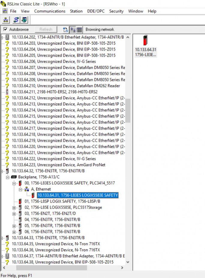

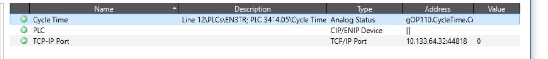

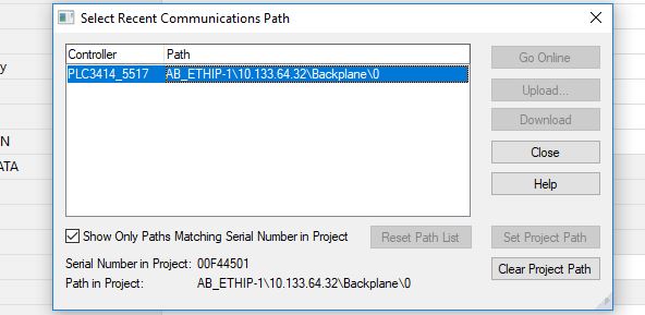

I am having an issue connecting to a ControlLogix PLC. See attached pictures about the backplane configuration and the current error on VTS. Any ideas? I can provide any further information as needed.
Lastly, using a C-More touchscreen, and I can access the main CPU through 10.133.64.31, backplane port 0, easily.

In some cases '[]' (without the quotes) is wanted for the port segment path. Also, if not already done, you may want to try plugging the network cable into the front RJ45 port.
