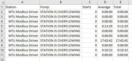

{edit} Thanks, I think Andrew's suggestion worked to get the condition logging. However running the report provides this result: 5e43f5d51972a
This gives the "runtime" of the overflow condition but it does not give a breakdown by day, and the Station column is defaulting to the modbus driver's description rather than the description of the respective context tag used to group each station's tags together. I think if a month was ran on the report I would have just a summation of hours for each station for the month.
The report I would like would list the complete tag description with parent tags, and provide a daily breakdown with time active for each day. So if I ran a report for one month, I would have 30 days with hour values for each day for each selected station. I have ran through all of the available reports and have not found one that would work, the detail report comes close but isn't very clear on what it is reporting for this case.
{edit} Thanks, I think Andrew's suggestion worked to get the condition logging. However running the report provides this result: ![5e43f5d51972a](serve/attachment&path=5e43f5d51972a) This gives the "runtime" of the overflow condition but it does not give a breakdown by day, and the Station column is defaulting to the modbus driver's description rather than the description of the respective context tag used to group each station's tags together. I think if a month was ran on the report I would have just a summation of hours for each station for the month. The report I would like would list the complete tag description with parent tags, and provide a daily breakdown with time active for each day. So if I ran a report for one month, I would have 30 days with hour values for each day for each selected station. I have ran through all of the available reports and have not found one that would work, the detail report comes close but isn't very clear on what it is reporting for this case.
