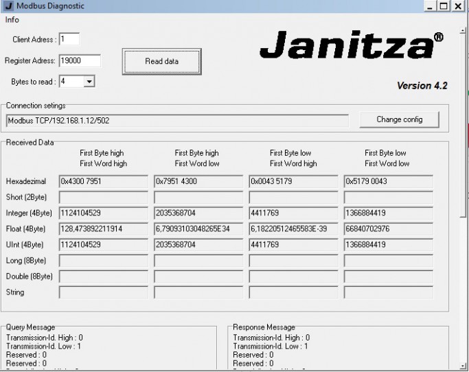

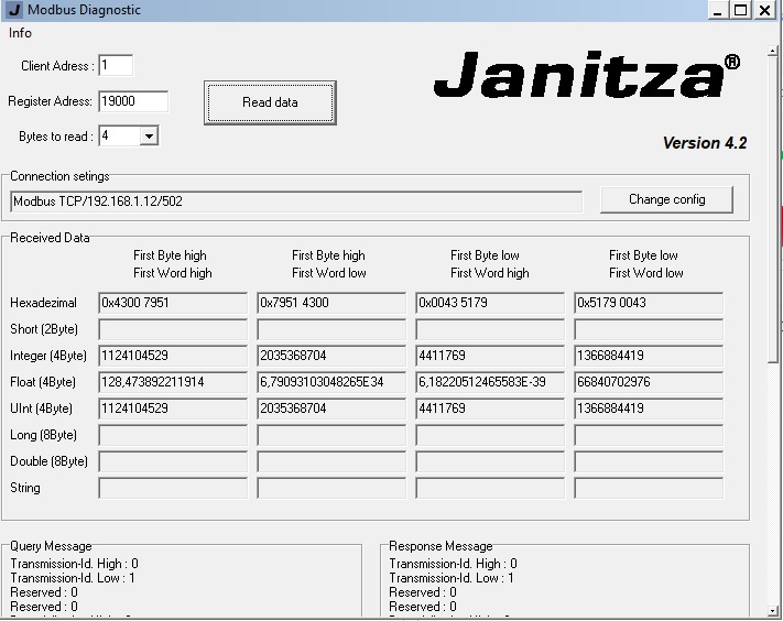

I tried the modbus communictation using the modbus Diagnostic from Device Manufacture and it´s working properly.
5ef0b1d1123fb
I tried the modbus communictation using the modbus Diagnostic from Device Manufacture and it´s working properly. ![5ef0b1d1123fb](serve/attachment&path=5ef0b1d1123fb)
Using 419000/Float the communication is confirmed but the data is not working. I change 419001 and other but keep not working... I have no more ideas of what could be changed... Are there some suggestion?

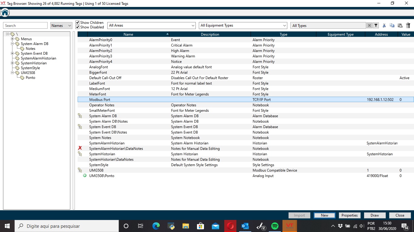

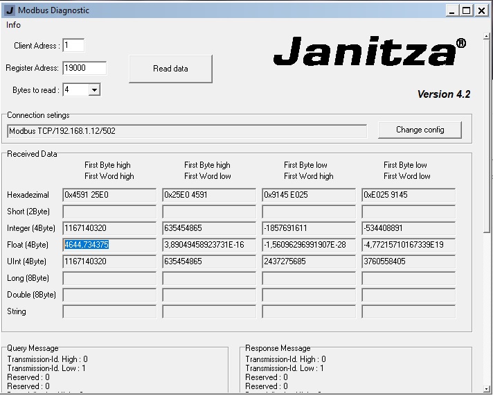

Hi Dougs,
My device is configured as slave. And I get the information from VTScada and Janitza comunication at the same time...
5efb85013ba98
5efb8501a7108
As you can see from Janitza comunication tester is working....
I´m not familiarized with Wireshark.
Tks
Hi Dougs, My device is configured as slave. And I get the information from VTScada and Janitza comunication at the same time... ![5efb85013ba98](serve/attachment&path=5efb85013ba98) ![5efb8501a7108](serve/attachment&path=5efb8501a7108) As you can see from Janitza comunication tester is working.... I´m not familiarized with Wireshark. Tks

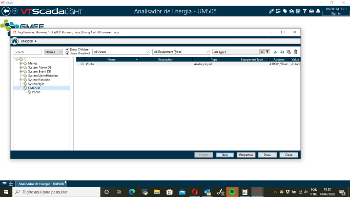

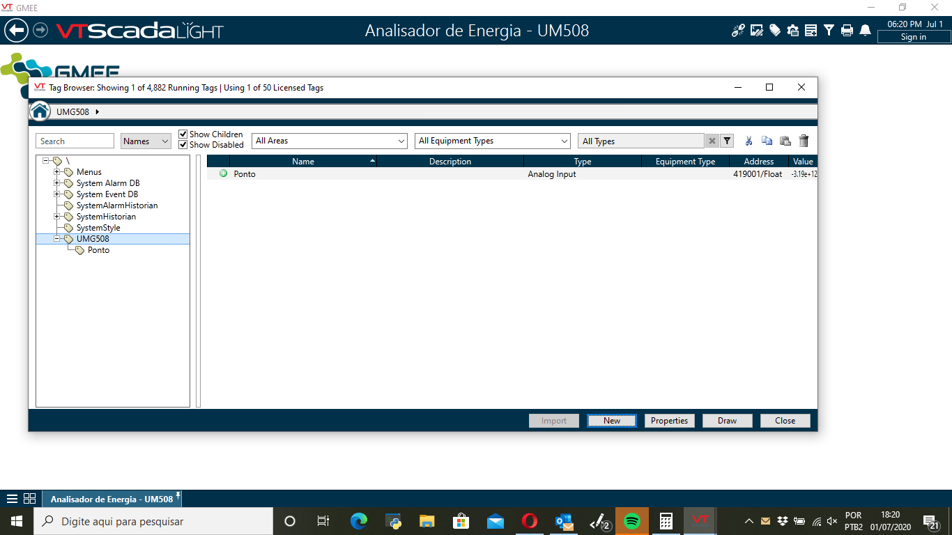

I had already tried and it made me think about the data format.
Look below...
5efcfdb537681
tks
I had already tried and it made me think about the data format. Look below... ![5efcfdb537681](serve/attachment&path=5efcfdb537681) tks

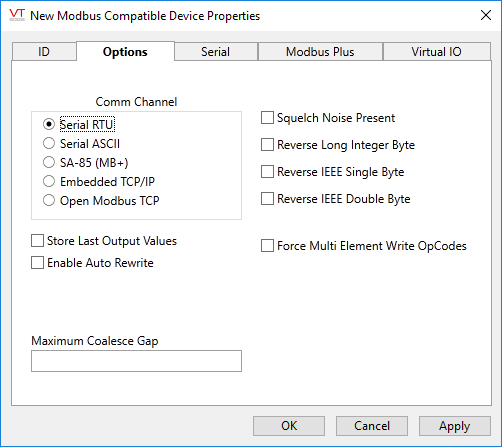

what about 319000/Float and 319001/Float?
and since there seems to be some data, have you try checking the Reverse IEEE checkboxes on your Modbus Compatible Device tag?
what about **319000/Float** and **319001/Float**? and since there seems to be some data, have you try checking the **Reverse IEEE** checkboxes on your Modbus Compatible Device tag?
edited Jul 1 '20 at 10:24 pm
Try all 4 combinations of the IEEE byte order on the Modbus driver on the same address you are reading. That very much looks like a word order error.
