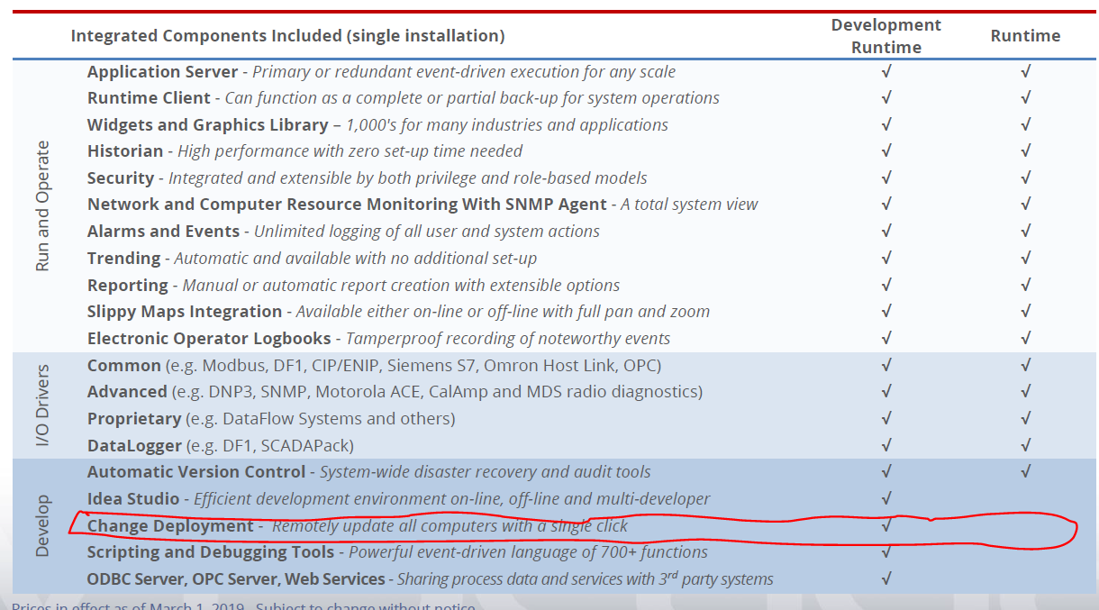

Hey Brian - You need a Dev license to deploy a changeset. See the following:
5f85b97b433a6
Regards,
DW
Hey Brian - You need a Dev license to deploy a changeset. See the following: ![5f85b97b433a6](serve/attachment&path=5f85b97b433a6) Regards, DW

DanW says that the client needs a development license to deploy changeset. The attached image circled line item is for "remotely update all computers". This is not what we are trying to do. We are trying to update ONE LOCAL COMPUTER.
Then Dave says the reason is possibly account privileges. So Dave, are you then disagreeing with DanW? I will not be happy wasting time messing around with permissions if the license simply doesn't support this. (and that makes no sense because it is a run time system and if you cannot load changes then what good it is to anyone?)
Now I am even more confused. DanW says that the client needs a development license to deploy changeset. The attached image circled line item is for "remotely update all computers". This is not what we are trying to do. We are trying to update ONE LOCAL COMPUTER. Then Dave says the reason is possibly account privileges. So Dave, are you then disagreeing with DanW? I will not be happy wasting time messing around with permissions if the license simply doesn't support this. (and that makes no sense because it is a run time system and if you cannot load changes then what good it is to anyone?)
Hey Brian - You're correct. Remote Update isn't what you're trying to do so ignore what I said. I defer to Dave.
Please also remember that this is a forum. For actual technical support you probably should reach out to your local VT Distributor.
My apologies for any confusion I may have caused.
Regards,
DanW
Hey Brian - You're correct. Remote Update isn't what you're trying to do so ignore what I said. I defer to Dave. Please also remember that this is a forum. For actual technical support you probably should reach out to your local VT Distributor. My apologies for any confusion I may have caused. Regards, DanW
