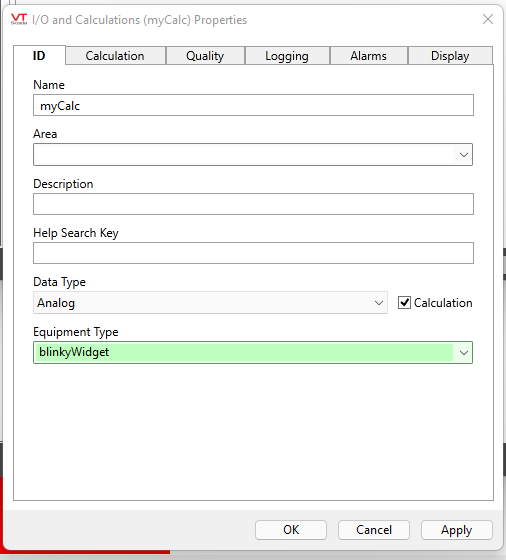

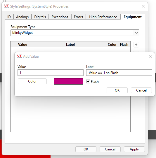

I believe the solution to this exists within the style tag. open up the style tag and create a new equipment type using the style you like (with flashing). See Below:
61c1dc45648db
61c1dc455d673
Edit: I should have also noted that you should probably link the image you want to display to an existing widget type in by editing the widget properties. Draw any pump or valve widget and, in the image section of the properties, click select. If this does not work for you, you could use a ternary expression in the opacity but the first expression which comes to mind would be less efficient than using the equipment types.
I believe the solution to this exists within the style tag. open up the style tag and create a new equipment type using the style you like (with flashing). See Below: ![61c1dc45648db](serve/attachment&path=61c1dc45648db) ![61c1dc455d673](serve/attachment&path=61c1dc455d673) . Edit: I should have also noted that you should probably link the image you want to display to an existing widget type in by editing the widget properties. Draw any pump or valve widget and, in the image section of the properties, click select. If this does not work for you, you could use a ternary expression in the opacity but the first expression which comes to mind would be less efficient than using the equipment types.
