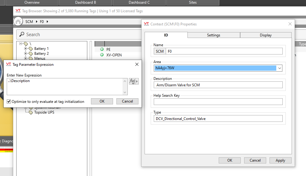

Does anyone else get gibberish when they reference the equipment type or description properties in an expression?
63dc3626d058a
For some properties like Name, I get the value I expect, and others return strange values.
Does anyone else get gibberish when they reference the equipment type or description properties in an expression? ![63dc3626d058a](serve/attachment&path=63dc3626d058a) For some properties like Name, I get the value I expect, and others return strange values.
Since VTScada 12, when multi language support was introduced, text properties refer to the Phrase Key rather than the phrase itself. You'll need to use a call such as \GetPhrase(..\Description) to get the string you are looking for.
You can learn more about this and view some examples here: https://www.vtscada.com/help/Content/Pro_Functions/GetPhrase.htm
Since VTScada 12, when multi language support was introduced, text properties refer to the Phrase Key rather than the phrase itself. You'll need to use a call such as \GetPhrase(..\Description) to get the string you are looking for. You can learn more about this and view some examples here: https://www.vtscada.com/help/Content/Pro_Functions/GetPhrase.htm
