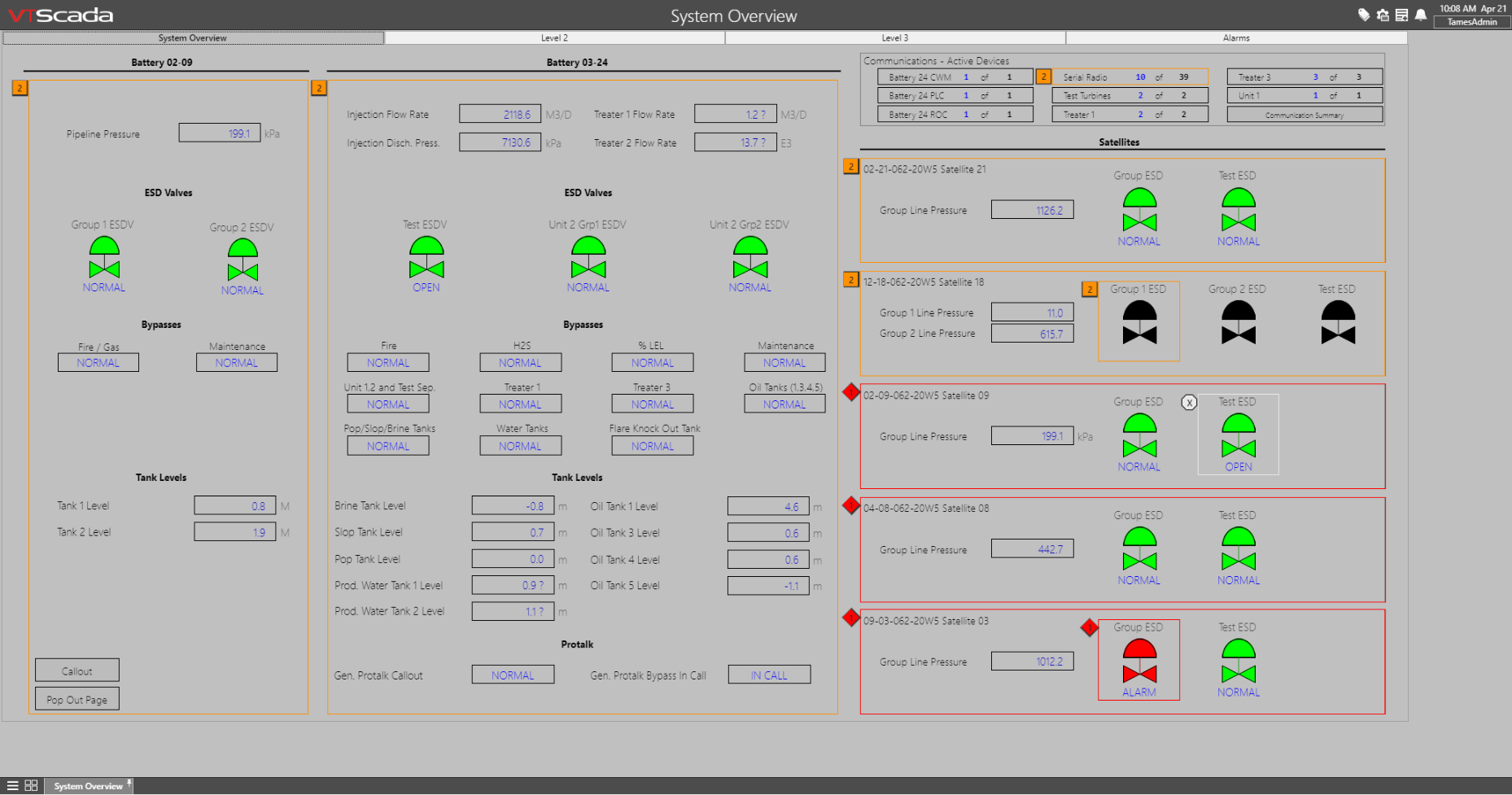

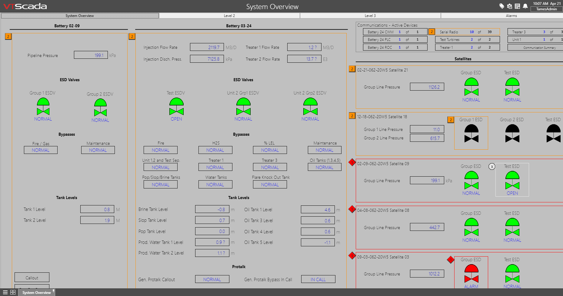

So I was able to get the screen to change with editing the parameters, the next issue is that no matter what I changed the sizing of the VTScada screen did not fit to the size of the web window. While the web window is at 100% the VTScada screen is ever so slightly zoomed in, and when I set the web window to 90% I am able to see everything.
In the settings of VTScada I can change every option for window size, ratio, or H/W but it does not solve the issue. Would the fix be somewhere inside the VTScada pages themselves?
Examples Below:
The first image is 100% and the second is 90%.

I believe the issue is that the page is attempting to fit the content to the available canvas. Sometimes I will add a small line or something to the edge of a page and make it invisible to give the page more padding when content is being best fit. You can also look at the page properties to try defining a size for the page (or try it blank if there is already a definition).
I haven't noticed issues here in my apps lately but I will try messing around with some settings to see if I see something similar.
You can also try loading the content here to see if it renders correctly for you: https://vts.trihedral.com/waterdemo/3402a388-aaf3-42a5-aedd-2f00398d25a3/ANYWHERE/
User/Password: demo/demo
