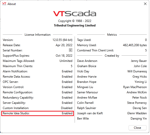

Thanks for checking back on this. Can you check the info panel in the settings to determine the version of VTScada you are running and determine if your key has the remote internet client enabled? YOu'll need to ensure that it shows as enabled (which it should for any version 12.0.X license with development) Note that not all servers have development and it is common for only one server in a redundant system to have development. You may need to use the vic to connect to the backup server to access the Idea Studio.
I just checked this on a test app, and it all worked as expected with no special permissions on my machine. I also wasn't able to see anything (in a quick scan) which would be a default on a new app but may not be enabled on an older app which has been upgraded:
6268912d4841f
Thanks for checking back on this. Can you check the info panel in the settings to determine the version of VTScada you are running and determine if your key has the remote internet client enabled? YOu'll need to ensure that it shows as enabled (which it should for any version 12.0.X license with development) Note that not all servers have development and it is common for only one server in a redundant system to have development. You may need to use the vic to connect to the backup server to access the Idea Studio. I just checked this on a test app, and it all worked as expected with no special permissions on my machine. I also wasn't able to see anything (in a quick scan) which would be a default on a new app but may not be enabled on an older app which has been upgraded: ![6268912d4841f](serve/attachment&path=6268912d4841f)

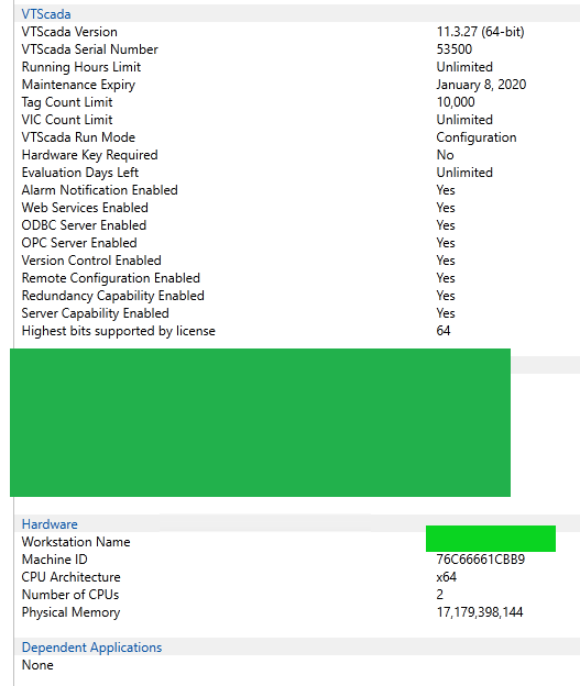

Hello Dave,
I went in and checked the information on the site. The site has an older version of VTScada on site (Vr11) Would that be messing with the access to the Idea Studio? Other than that I cant see anything that would indicate if the Remote Idea Studio is disabled or not. 6269bcb019d24
Hello Dave, I went in and checked the information on the site. The site has an older version of VTScada on site (Vr11) Would that be messing with the access to the Idea Studio? Other than that I cant see anything that would indicate if the Remote Idea Studio is disabled or not. ![6269bcb019d24](serve/attachment&path=6269bcb019d24)
Ok, this is the problem with getting development access through the VIC. In your case, I would check with your technical salesperson or the Integrator you worked with on this. If you have Support Plus with us, you can move to version 12 at no cost by updating the keys when you run the installer. If not, the sales folks can give you a quote to renew your support so you can upgrade.
