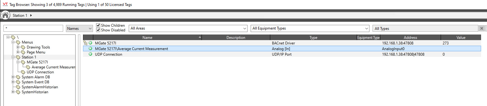

Here is what VTScada is showing:
6290026f65914

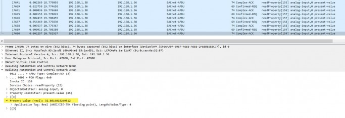

but here is the proper value coming back within wireshark:
6290031aa3097
Any help is greatly appreciated, this is really holding back a project proposal.

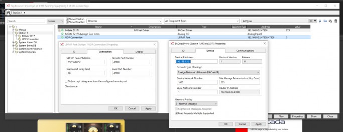

I took a screenshot of both my UDP port settings as well as the BACnet driver settings. On the left is the UDP properties and on the right will be the BACnet Driver Properties. I do want to mention on the BACnet driver, after the Device IP address I entered a (:1) instead of (:4780smile because my device used a virtual BACnet MAC address of c0:a8:7f:04:00:01. I was not getting the proper responses within wireshark when I had left it at the default of :47808

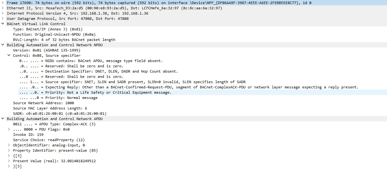

Below is the screenshot of the NPDU group of the wireshark trace.

I reviewed the NPDU field as you mentioned and I do not see any issue as to why VTScada is giving an error. I compared the field with a working YABE Client and they are identical. I am not sure what else to look into at this point.
