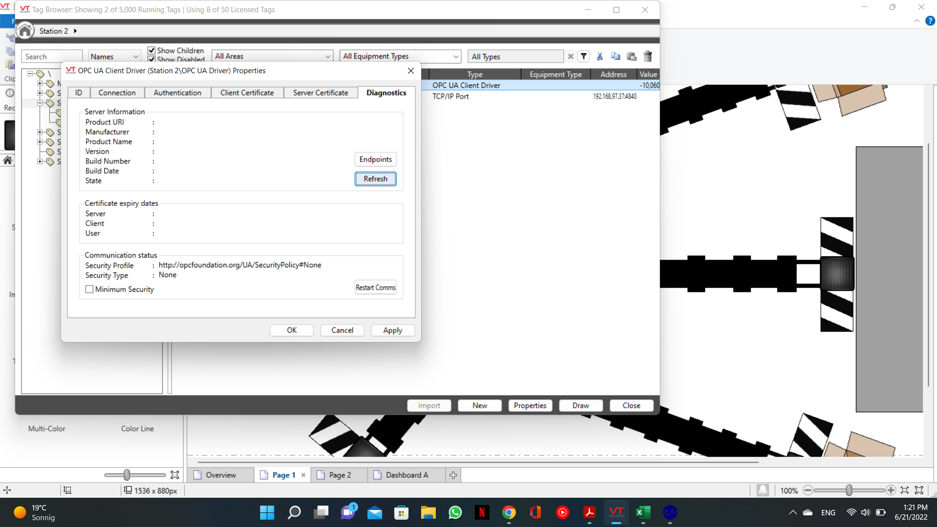

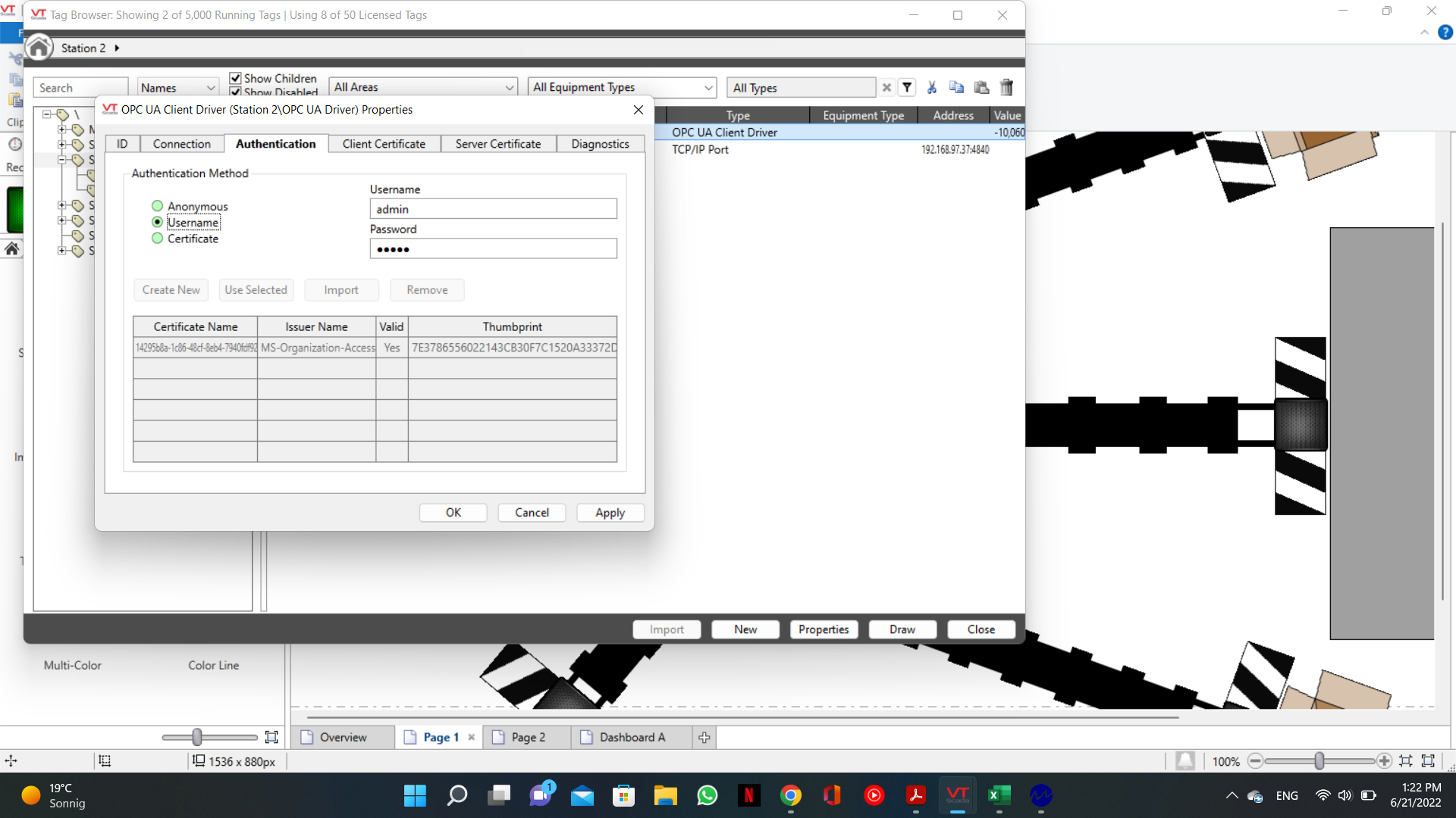

This is what my screen looks like it would have been beneficial if i was gettin some error notifications as to why I am not getting any readings in the diagnostics page.
![62b31c4ec8e23](serve/attachment&path=62b31c4ec8e23) ![62b31c4f5144a](serve/attachment&path=62b31c4f5144a) This is what my screen looks like it would have been beneficial if i was gettin some error notifications as to why I am not getting any readings in the diagnostics page.

Drawing the Comms Stats widget for the OPC UA Client Driver gives some error info.
I can just see in the image of the tag browser that the driver error code is -10,060, this error code is a connection timeout which probably explains why you aren't seeing any diagnostic info.
I think this would be easier to handle if you contact Trihedral support where they can forward on things such as a Wireshark traffic capture to allow someone to investigate the issue.
Sorry for the delay in replying. Drawing the [Comms Stats](https://www.vtscada.com/help/Content/D_Widgets/Dev_CommStatisticsButtonWidget.htm) widget for the OPC UA Client Driver gives some error info. I can just see in the image of the tag browser that the driver error code is -10,060, this error code is a connection timeout which probably explains why you aren't seeing any diagnostic info. I think this would be easier to handle if you contact Trihedral support where they can forward on things such as a Wireshark traffic capture to allow someone to investigate the issue.
