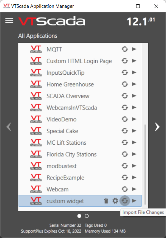

You just need to click the import changes button for that application in the VAM. It looks like two arrows going in a circle (Click the image to see the full thing and note the last application in the list).
62b604faa3954
You just need to click the import changes button for that application in the VAM. It looks like two arrows going in a circle (Click the image to see the full thing and note the last application in the list). ![62b604faa3954](serve/attachment&path=62b604faa3954)
edited Jun 24 '22 at 7:41 pm

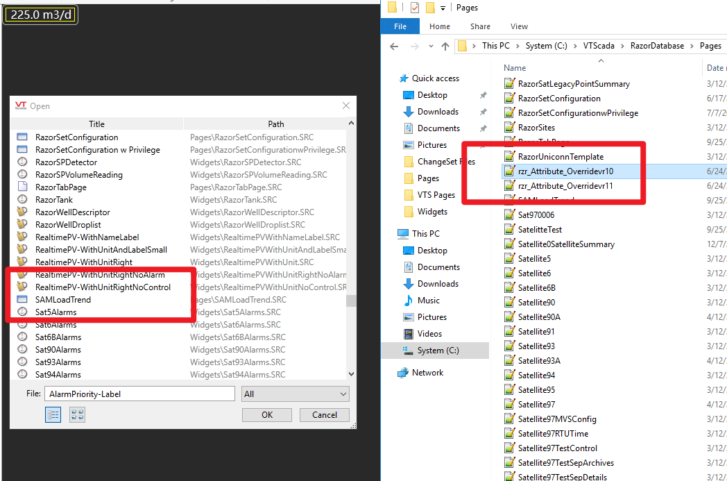

I have been trying to get the refresh to work but I think I might have done something to block it from working. I had a few versions saved in the folder so I opened them up in the idea studio and permanently deleted them. Once I had the working version left (version 10) I opened it and right clicked the tab at the bottom and changed the name back to the original page. This seemed to have caused some weird issues.
After trying to change the file and refresh a few times now I cannot see any pages in the idea studio and there are two versions in the file folder (version 10 and 11) Ill attach a picture below to show what I am currently seeing.
Version 11 was brand new, and on the last refresh a brand new dialog box appeared asking me if I wanted to load the version 11 page into the application, but then I don't see it in the Idea Studio to open it.
