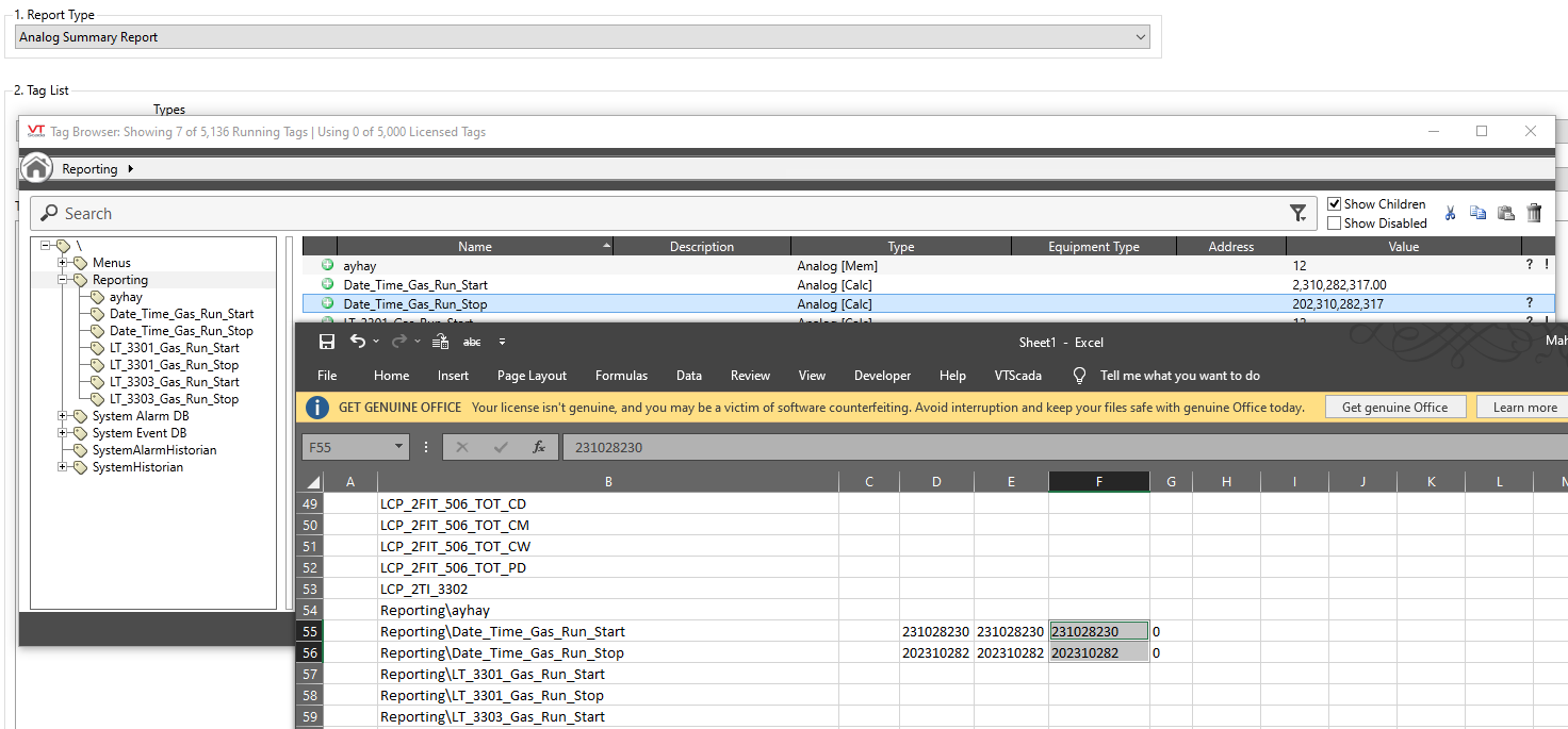

I wrote a calculation(analog) tag to show datetime and that value will export to excel but excel is cutting the last 3 digits.
I used the following expression, and it gives the value 202310282319 which i need to process in excel but that's fine.
CONCAT(Date(Today(), "yyyyMMdd"), "", Time(Now(1), "HHmm"))
  • Giving hyphens between dates don't work for analog tags. I cannot change to string types because I am generating "analog summary report" and all other tags are analog tags.
653d39f8807ec
For the tag Date_Time_Gas_Run_Start, using yMMddHHmm instead of 4y gives 23 for year 2023 but even so the minute is still not showing fully. Then I put decimals in tag property just because.
My question is why this is not working. And do i have to use 2 tags? 1 for date and another for time?!

Does the same for me too... seems to work if I keep them seperate tags, i.e. one for time and another for date, if you can work with that. Hopefully someone will pick this up from Trihedral and explain...

The number of digits in the output is dependent on the type of report used.
The Analog Summary Report has the Min, Max, and Avg values limited to 9 digits.
Other report types have higher limits and should be adequate for this purpose.
The HDV Export Wizard will also provide enough significant digits for this purpose.
