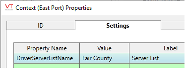

I have added a setting in the past to change the server list for all child tags, using "DriverServerListName" setting in a parent tag. Does such a setting exist for historians as well?

Example of property name used to change server list.
65d7bab95bbc5
Example of property name used to change server list. ![65d7bab95bbc5](serve/attachment&path=65d7bab95bbc5)
