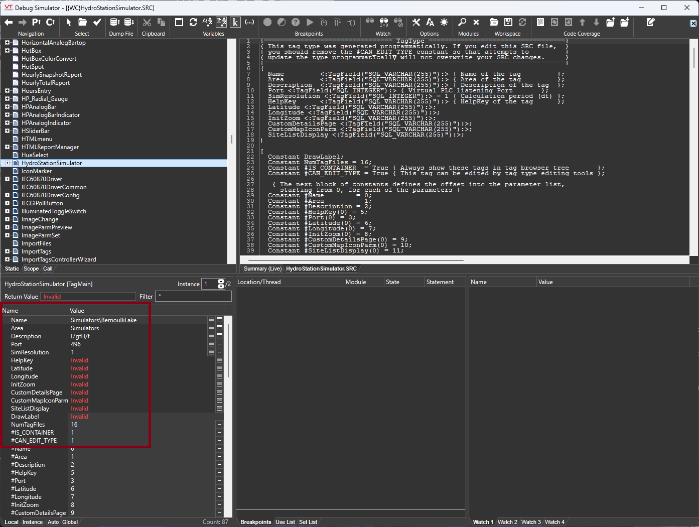

Can you create a new tag widget containing a text object and within the text object look at all the linked tag properties available?
I haven’t used it in a while but I thought source debugger could drill down into tag properties too.
Can you create a new tag widget containing a text object and within the text object look at all the linked tag properties available? I haven’t used it in a while but I thought source debugger could drill down into tag properties too.
If you open the Source Debugger and look at your application, you can typically look at any tag type and see most of the properties and methods available. This is a more advanced method but, if you can learn the basics of the source debugger, you will probably find it very helpful to find tag properties.

If you open the Source Debugger and look at your application, you can typically look at any tag type and see most of the properties and methods available. This is a more advanced method but, if you can learn the basics of the source debugger, you will probably find it very helpful to find tag properties. ![66f6bc3f46e7c](serve/attachment&path=66f6bc3f46e7c)
