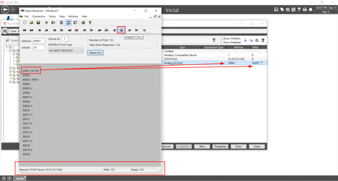

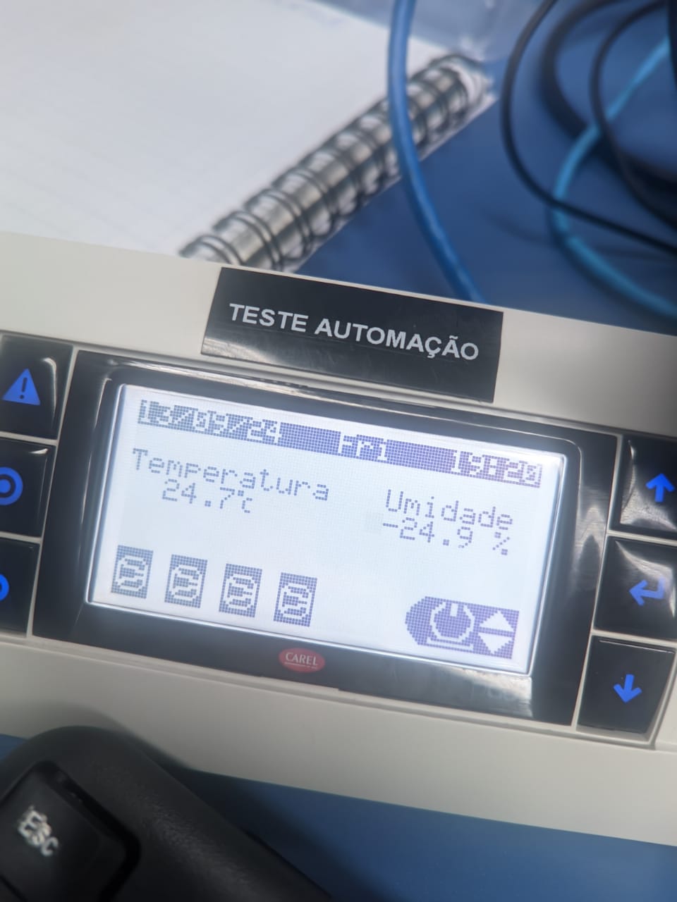

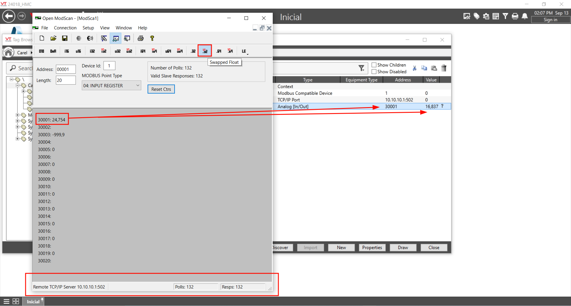

How do I read the variable in Swapped Float format in VTScada? Carel uPC3 via Modbus Compatible Device
How do I read this address from VTScada? I've tried all the Data Suffixes for Tag I/O Addressing but it didn't work. Below is the address "30001" in ModScan and its temperature reading. I've tried "30001/Float" but it didn't work.
I also tried to do it through BuffOrder but I didn't understand correctly how to set it.
66e47940293c9
66e479407249f

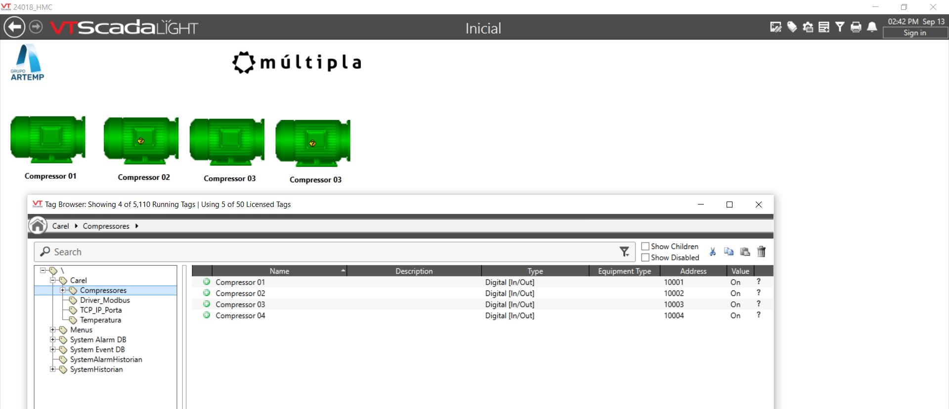

Regarding the "Coils" they are working perfectly.
66e4799250cec
How do I read this address from VTScada? I've tried all the Data Suffixes for Tag I/O Addressing but it didn't work. Below is the address "30001" in ModScan and its temperature reading. I've tried "30001/Float" but it didn't work. I also tried to do it through BuffOrder but I didn't understand correctly how to set it. ![66e47940293c9](serve/attachment&path=66e47940293c9) ![66e479407249f](serve/attachment&path=66e479407249f) Regarding the "Coils" they are working perfectly. ![66e4799250cec](serve/attachment&path=66e4799250cec)

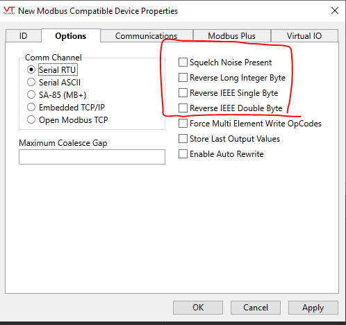

if i am understanding correctly, try adjusting these settings.
and then it sounds like you need to adjust the scaling in your IO tag.
66fc5f9cc1743
if i am understanding correctly, try adjusting these settings. and then it sounds like you need to adjust the scaling in your IO tag. ![66fc5f9cc1743](serve/attachment&path=66fc5f9cc1743)
