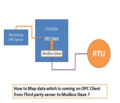

Hi Had attached picture where it seems that VTSCADA will take data from third part OPC server as OPC client .
In Same SCADA how to Map Modbus Client where data comming on OPC client can be mapped .
We have Modbus Master as PLC .
Need guidance on same
![5c5575439d9bf](serve/attachment&path=5c5575439d9bf) Hi Had attached picture where it seems that VTSCADA will take data from third part OPC server as OPC client . In Same SCADA how to Map Modbus Client where data comming on OPC client can be mapped . We have Modbus Master as PLC . Need guidance on same
Configure the appropriate input tag (digital, digital status, analog, analog status) to retrieve the value from the OPC Server via an OPC Client Driver.
Then configure a Modbus Slave using a Modbus tag and configure an output tag to write to the appropriate address in the slave. The output tag should use the input tag as the "data source". See the help on an Analog Output tag, specifically the "Data Source" property for more info.
