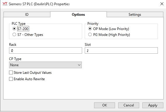

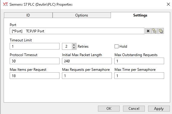

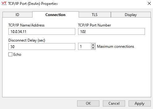

Hi Pieter,
I always get the error code 262 (connection timeout).
66168bcbecf3c
66168bcbf37ce
66168bcc015cd
I've done config like you describe... is there something that need to be enabled in the Siemens Logo ?
Hi Pieter, I always get the error code 262 (connection timeout). ![66168bcbecf3c](serve/attachment&path=66168bcbecf3c) ![66168bcbf37ce](serve/attachment&path=66168bcbf37ce) ![66168bcc015cd](serve/attachment&path=66168bcc015cd) I've done config like you describe... is there something that need to be enabled in the Siemens Logo ?
It's not a Logo programmed by our company... I went online and they didn't enable the S7 Access... It might all work, but the problem is from the Logo configuration...
