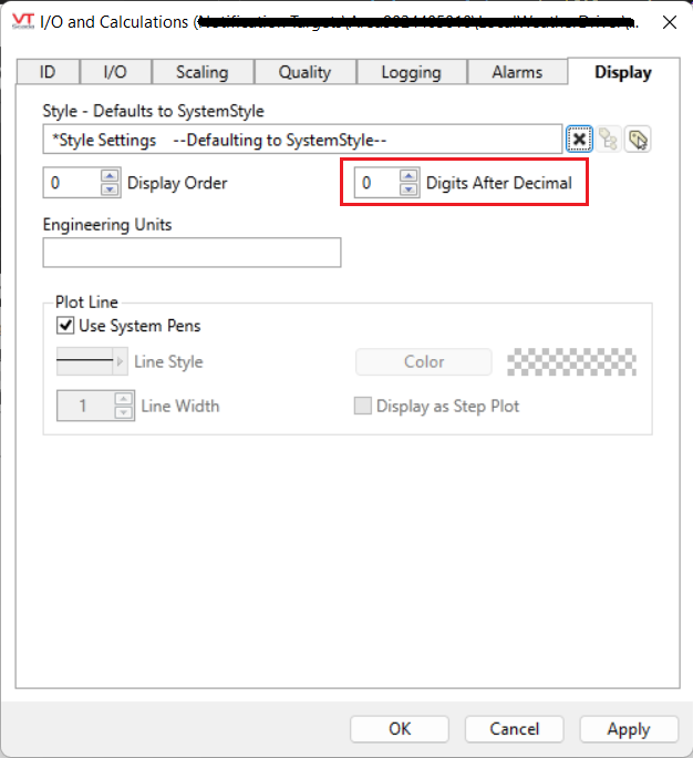

Look for this in the display tab of the I/O can calc tag. You can select the number of digits after the decimal to display. Note that this is only true for Analog (or non-discrete values).628f7822a6cfb
Look for this in the display tab of the I/O can calc tag. You can select the number of digits after the decimal to display. Note that this is only true for Analog (or non-discrete values).![628f7822a6cfb](serve/attachment&path=628f7822a6cfb)

If I am not linking this to a Tag is there a way? or is a Tag the only way?
The information I need to display is not live data or anything it is just groups of information that will remain static.
Just don't want to create a bunch of random Tags if I don't have to.
Thanks.
If I am not linking this to a Tag is there a way? or is a Tag the only way? The information I need to display is not live data or anything it is just groups of information that will remain static. Just don't want to create a bunch of random Tags if I don't have to. Thanks.
